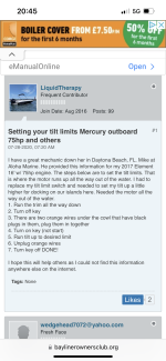

I can’t send you the manual. But there is a quick way to do it. Try this
