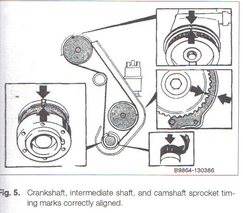

I can send you pic's of how I set up the timing on my engine, a B230 which is basis for both the AQ125 and 131.
Here is a pic looking at timing gear from the rear/top of engine the red/yellow thing at top is the heat exchanger lip which covers the gear making it hard to see.
Crank is at TDC (actual) the timing mark on the harmonic dampener is not always accurate.
That is the camshaft gear!
OP...just check your timing with a timing light. If it's not off, you didn't slip.
I have replaced timing belts in these engines at least 5 times back in the day. I have never seen a timing belt slip once.
