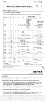

BF40A Sn BAYL-2000515
Had some bad gas so I cleaned the carbs and replaced main jet #92 99101-ZV5-0920
as well as jet set 16150-ZV3-000 and seals and gaskets.
I don't know if my BF 40A sn BAYL-2000515 wants an initial 1 5/8 turn out on the new replaced pilot screws or 2 1/4.
The service manual seems to indicate BAYE and subsequent want 1 5/8 turn out.
It will not idle except with about 1/4 choke.
Carbs were balanced but the idle circuit must be clogged?
If i close the choke it will not idle (it dies).
I can close the pilot screws (fuel mixture) on each carb and it doesn't seem to make any difference.
I.will add the bottom carb idle is all the way tightened and still idles too

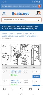

waldo753
Jan 20, 2025
The carbs were solvent cleaned (don't have an ultrasonic cleaner) twice. I will take them apart again and this time use a remote tank to get it running while I take steps to clean the on board tank since it must be getting dirt from the built in tank.
I have replaced the jets gaskets and orings last cleaning and I ordered another set of orings for this cleaning.
I also ordered 3 carb covers (part 18) since the bottom carb was leaking when I squeezed the primer bulb...which I read can be caused by a clogged main jet.
I think the carb cover seals is just a press in fit. I tapped the carb cover in and the leak quit so not sure I should replace them.
I will check out the gaskets and isolators when I disassemble them....or should I replace the gaskets even if they look okay?
My local Honda dealer doesn't work Carburated motors anymore. So I'm learning quick.
