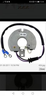

Thanks for your reply. Its definitely not got points and condenser. Below is a picture i got from google. This is whats inside it.

That one is no longer made. Has been replaced by a few others like Sierra 18-5239
Autolite makes one also Pertronix
Most likely that module has gone out, and needs replacing
