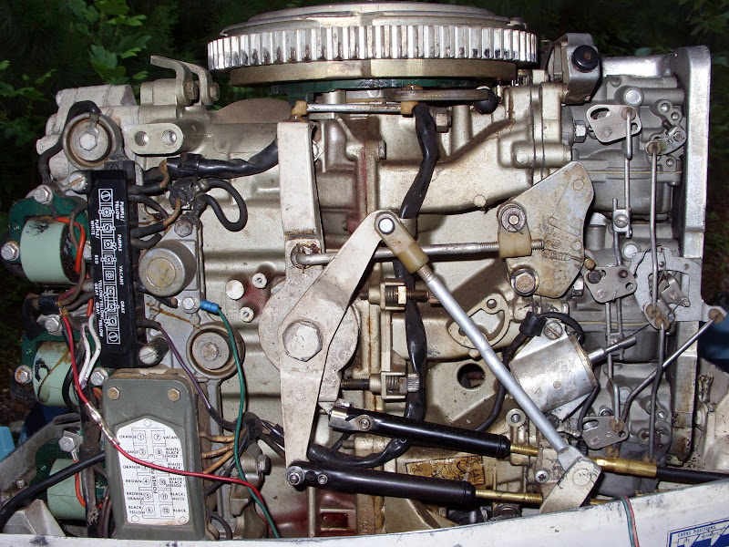

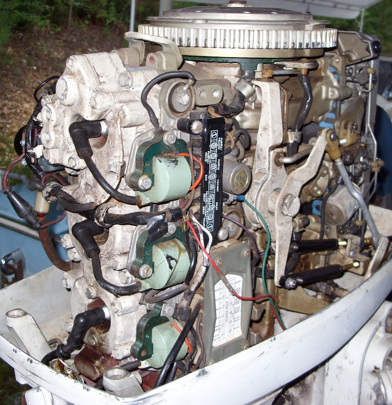

Thanks for all the info, jtexas. I'll look into all this asap and let you know how it goes. It definitely sounds like the problem. In the meantime I'll put some better photos of the engine up here so you can get a better look at it. The plastic cap does appear to be missing that you spoke of...not exactly sure where you would find a replacement but I suppose it could be ordered off here or somewhere online...
Also, do you know what the screw above the idle set screw controls? (Best seen in images 1 and 2)
Sorry about all the 'beginner' questions but this is the first boat I've ever worked on so it's a pretty new experience for me and I appreciate all the advice.

jtexas
Oct 13, 2003
8,646
Re: Gas feed problem with 1974 Evinrude 70hp..
that's your WOT stop screw, set it to where it stops the throttle lever when the throttle butterflies are horizontal.

I took another short video clip of the linkages where you can see the timer base is indeed not moving at all. I thought seeing it 'semi first hand' would be better than just writing it out here. It's explained with better detail in the video clip below(Sorry the audio is kind of low - you may have to turn up your speakers a bit):
Here's the engine running in a test tank and we're attempting to put it into gear but it dies immediately as you can see (You may want to turn your speakers back down for this one):
It appears the spring that's in the fixture where the timer base and throttle linkages connect is good and for the most part clean. Any ideas why it isn't moving at all? Thanks.
jtexas
Oct 13, 2003
8,646
you pulled the timer base back -- it's s supposed to start out back, and move forward. the rubber stop that it's resting against now - that's what stops it's forward travel.
I'm not sure what year is shown here, but see the how the cam and throttle lever are angled back more than yours in neutral? (ignore the yellow arrow)
My boat's at a storage yard but I'm going to have it here tomorrow, prepping for camping later in the week. It's a '79 - very little difference in appearance and the linkages are all pretty much the same. Then I won't have to work from memory.
Any chance you could get your hands on a manual - the "link & sync" procedure is pretty specific, model to model.
