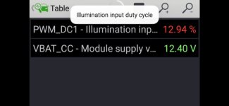

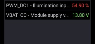

I try to update as built sata but there are no EATC on motorctaft website
I use forscan to read live data
I found that manual climate control illumination input duty cycle is 12.94%
And the Automatic climate control illumination input duty cycle is 54.90%
Is there a way to reduce this percentage?
Any one can help me?
