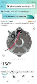

Like this
51,887
It shows 105 amp
You have to rewire your boat to use anything over a 42 amp alternator.
It can be done, however you need to replace wiring from the alternator to the battery and the helm. You have to bypass the ammeter.

It also has no exciter wire....and they haven't answered on a price. So what's the deal on the exciter wire...an alt without one is no good for me or what
51,887
maybe google the part number.
or get your old Delco rebuilt
or get a higher output alternator and change the wiring
