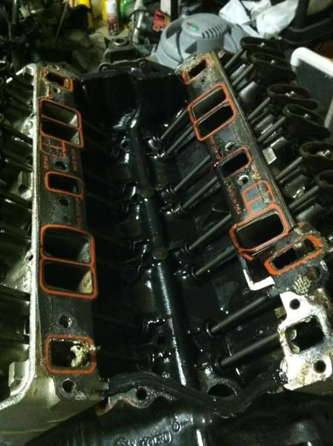

When I took the intake manifold off the oil in the intake valley had 0 water in it. The intake mani is an Edelbrock high rise. The intake mani gaskets looked ok to me but they used the rubber pieces for the front and back of the block. I read your not supposed to use the rubber pieces and you're supposed to use RTV instead.

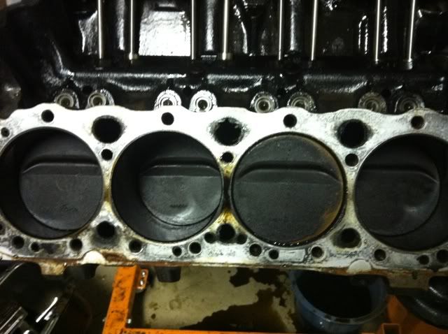

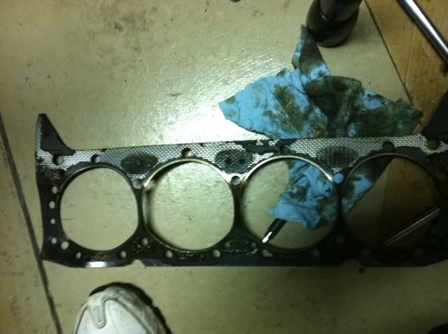

I took the heads off and there was no headgasket problems. They were metal (SS) gaskets.
Think this little bit of waterish sludge in the bottom of the pan and the little pool in valley on the head is a problem? Could it be from the engine sitting on the floor for 3 months? The rest of the oil and places where oil was sitting looked fine no water.

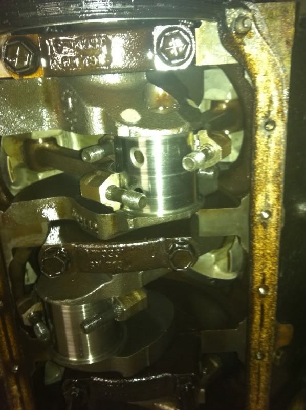

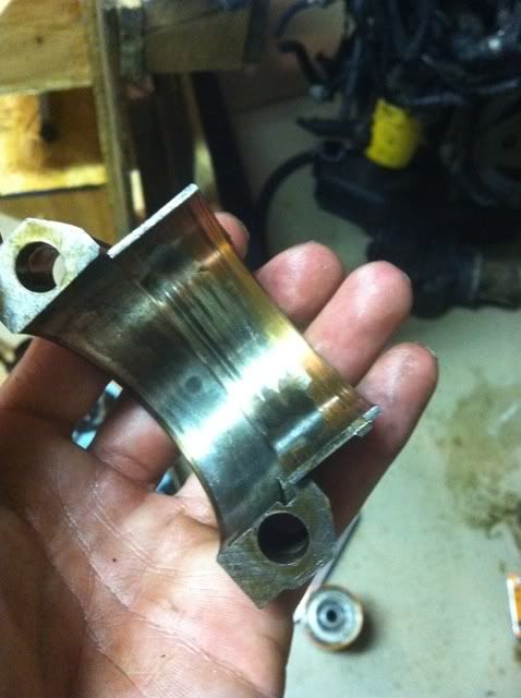

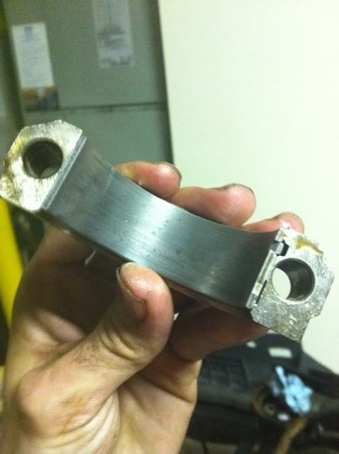

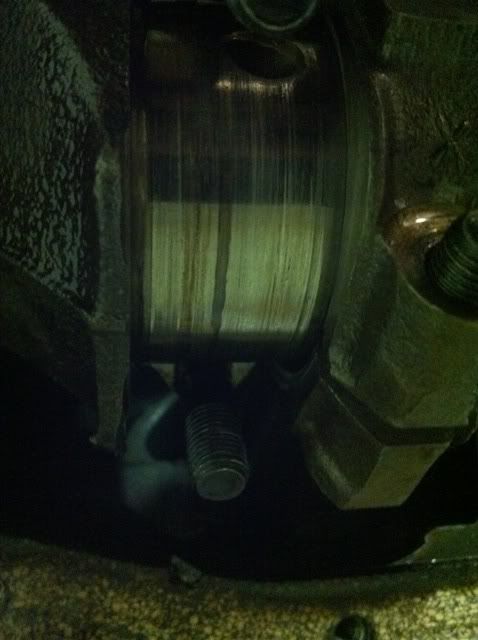

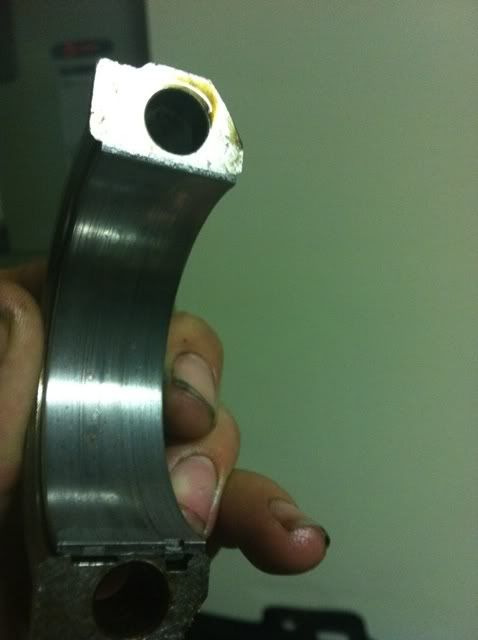

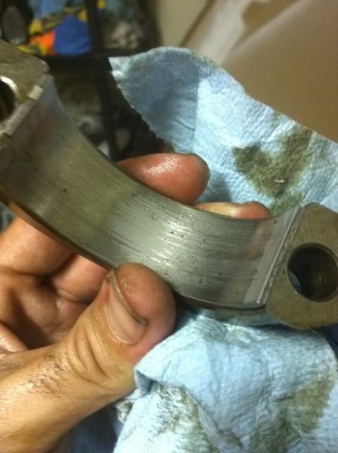

Now to the big part. When I dropped the pan I took the end caps off 2 at a time and checked the bearings. I dunno what constitutes a spun bearing but I think 3 of them are spun and one (#8) REALLY bad.
Ive attached pics so you guys can tell me what you think. I can see some wear on most of them (I think) but I cant feel it, even with my nail. Obviously the two with the copper colored line I can feel and #8 was separated from the cap when I took it off cause its so shot.
So should I replace all of the rod bearings? Or just the bad ones? Should I first take the crank to a machine shop and see if they can fix it?
What do you guys think?

a decent shop can recondition the crank like new and recondition the rods.
just have the shop order the correct size bearing

None of your bearings are "spun". That is what occurs when the bearing shell starts to spin in the rod or main bore, and the surrounding metal will be discolored by the heat.

What is the copper discoloring on some of the bearings? Is that what your talking about? I didn't see any of them spun like moved around the journal.
So the #8 one, the one that looks really bad with the copper discoloring, that ones ok? It made some decent marks on the crank that I can feel with my finger.

Copper is the "inside" of the bearing, the outer babbit of the bearing has been worn away,,, lack of oil.
As BT said, time to visit the machine shop, grind the crank, check the rods, replace ALL of the bearings. I'd never reuse an old rod/main bearing, especially the messed up ones you pictures. Only way I'd reuse them is if they were practically new and looked new. Plus, when the crank is ground, none of the old bearings will fit anymore.

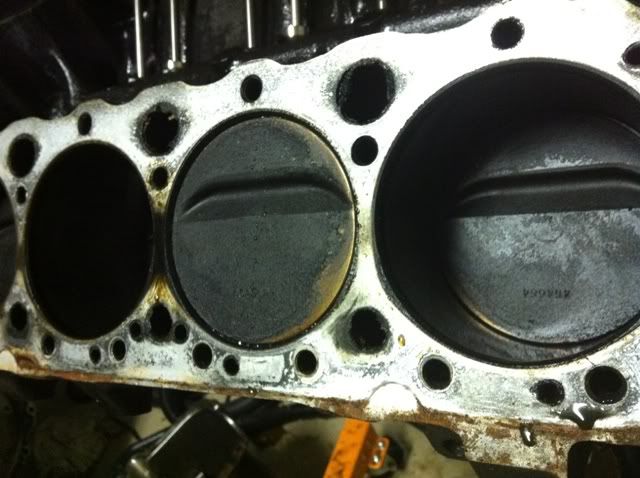

I notice on a couple of the cylinders that there will be a little bit of oil on the cyl wall. If I wipe it off then turn the engine by hand, the piston comes up, then when it goes back down it leaves a little tiny bit of oil on the cyl wall.
Does this mean the rings are bad? Could it be from me turn ing the engine upside down or something?
No, none of these are starting to spin, but the have excess wear.
Worn away, yes. Lack of oil, maybe.
This is in some cases, normal, but excessive wear.
Its time to rebuild, but not spun. You will know when they are spun, they are black and more often then not, not even there anymore.
By the way, as per one of the pics of the block, you did have a blown head gastket, between the 2 middle cylinders.

Oh I thought it was blown if the gasket was actually broke. So that could be where the water was coming from?
No, its not always gone, its takes awhile to completely blow it out.
As for the water, maybe.

Several problems I see. wiped bearings, leakage between cylinders, one piston is allowing oil into the cylinder. A leaking head gasket does not let water into the cylinder..it's the other way around. Compression pressure (2000psi or so) leaks into the water jacket.

Oh, by the way, those are Fel-Pro intake gaskets. They're the best.

Another thing is the intake mani on there was a Edelbrock high rise aluminum. The boat was used in salt water. There was a good bit of stuff in the water passage in the intake manifold.
I already bought a new complete engine for my boat a few months ago. this is just a project I want to do as a learning experience.
Can anyone comment on the use of the rubber gaskets on the front and back of where the intake mani meets the block?
I have read that you should use silicone or RTV or whatever and not to use those rubber gaskets. Could that also contribute to the water in the oil?

RTV works great, especially if the heads have been milled but not the manifold..will squeeze out thinner. I use a special grey sealer, not regular RTV.
The rod bearings didn't spin. Are the bearing shells tight in the rods? If not, they may have been beaten by too much clearance. If they're loose, the big ends may have been damaged from heat/impact and will need to be machined.
I see the corrosion in the manifold. This happens on street Vortec engines..the intake manifold corrodes and leaks.
