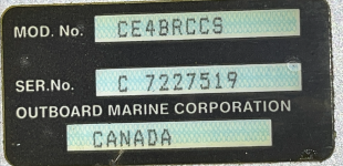

Hello,
Just bought a boat with an Evinrude 4hp motor.
As displayed on sticker:
Mod. No. CE4BRCCS
SER. No. C 7227519
I have a few issues with it, but while searching the web, can't find anything relating to it. Google search with the model number only results in one link of a post on this forum but dating back to 2006...!!
Any suggestions appreciated!
Thanks!

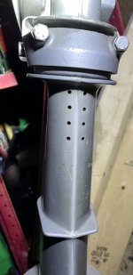

Thanks for the information. Yes, that looks like my motor (see pictures). And yes, there are 8 holes on the back of the leg that were certainly spitting out water and smoke, so I imagine that is where the water from the cooling system is spewed out ??

Only some of the cooling water spits out of those holes.-----Install a new impeller now.
