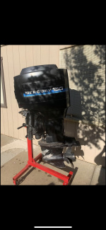

Including a picture of the motor just in case mid 80s 150hp isnt specific enough. I dont have a serial number or exact year. Sorry

That looks to be a 1st generation 2L. I would add a few coins and get a later model motor. If you do decide to try this one dont pay over $500-700 for it and make sure you get matching control box
