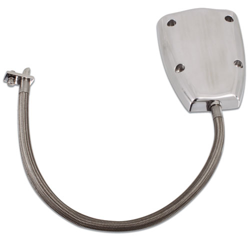

Also needing a drive shower and my builder tells me the ones with an actual top are better then the tube that spray water

Looks like I might go with this drive shower made by Hardin Marine. Eddie says the ones like this are better then just the spray nozzles.
