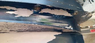

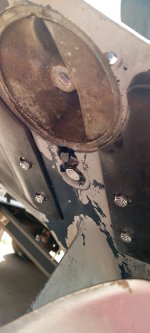

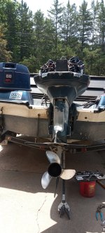

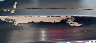

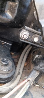

I got all the bolts out.. the shifter rod is disconected.. why won't this thing just slide down.. I got one bolt in and once I loosen it the gear case slides about 1/8" and stops.. it wiggles just doesn't want to come the rest of the way. Can anyone help? Am I missing somthing??

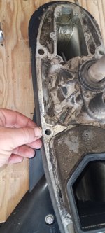

Got it!! Thanks. Now is there a sealant I should use when bolting back in?? Around the flange?

No sealant.----Do not turn shift rod during your work.----Better yet check shift rod height before re-assembly !
