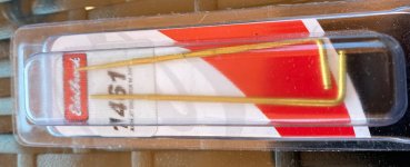

In the original V6 kit the primary and secondary jets are the same .89.1.jpg1.jpg
The rods were marked with 6857
Springs were pink
So I bought this tuning kit for the 1409
It does not contain the rods you mentioned. Luckily a found a shop who had them on stock.
So I chekced the float levels that were ok and the carb was clean inside.
Thank you again for solving my issue.
