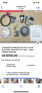

Here is an electric start kit,

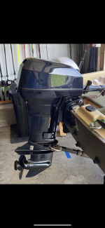

Yes Crosbyman I got the whole kit plus solenoid for $425.00. The reason for the question. My battery is not in an open area. It has a lid that I have to open to get to the battery. Can’t drill holes or anything. I wanted to be able to disconnect the battery from the motor when traveling and storing in garage. Would like a quick disconnect like an SAE design. This is my motor. I think it’s worth the $425.00 to convert to electric start?
