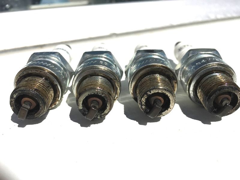

I really just wanted to have a shop make sure my WOT timing was right since I married two engines and suspect I'm a bit on the retarded side for timing. Tried daylight tesing but the sunlight washed out the strobe. Maybe I'll pick an early morning on a cloudy day and try again on the lake.
Sparkies look good after about 50 hours:
