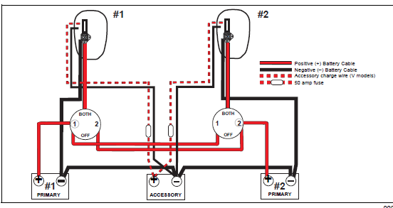

Many twin engine airplanes have but one battery. To save weight. Both alternators (one from each motor) charge the battery at the same time.
boscoe99
Aug 22, 2013
2,184
Diagram from Yamaha showing two motors providing charge current to one battery.
boscoe99
Aug 22, 2013
2,184
Diagram from Evinrude showing two motors providing charge current to one battery.

All alternator regulators have diodes that prevent the flow of current from a battery to the alternator.
I don't see a problem running both motors at the same time connected to the one battery. Each battery will contribute a bit of current to the battery.
But as the man suggests, if there is any concern just run one motor at a time.
