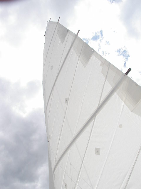

That sail certainly looks nice. You reminded my that a number of years ago Practical Sailor sent some dirty/tired sails to a number of different companies to see if their cleaning & reconditioning service was worth the money. As I recall they concluded that some did a pretty good job. I haven't read the magazine for a while, so they might done some tests more recently.<br />P.S. 3 reef points? You must be really serious.<br />If one reef wasn't enough, I would usually just motor home.
