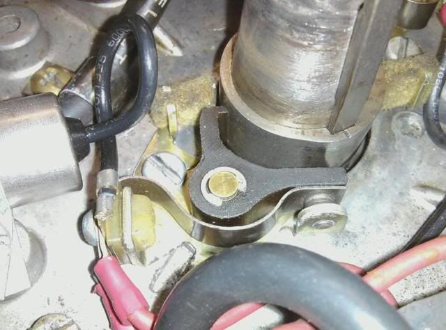

I think I was fouling my points with too much cam lube grease or oil. It appeared as if I was getting crankcase blow-by/vapor into the ignition area. I degreased the oily looking area (that is not as oily looking as the other pic or actual look). Then I used less grease on the cam and ran the 70 35HP Chrysler hard (LOL) 30 ish MPH about 8 miles. Re-checked for signs of blow-by/vapor directly after the hard run w/o seeing any signs (attached). I think this told me I was too heavy on the oil or grease vs blowby??. Good Luck! jow

Now that you mention that. I haven't greased mine since I got the outboard. so I'm thinking on your lines it's the blow by. How would I stop that? Never had the plate off the engine.

Forgive me Frank! I feel I would retire my boat before I pull the plate and bushing/seal if it?s allowing blow-by (which I feel is not common if properly maintained with mix). BUT! Consider finding the points and condenser ?to Specs? vs any condenser (I have heard you mention). I learned with VWs that any condensed vs the correct condenser would allow the points to pit or burn yearly or prematurely (transfer metal) vs residual cleaning?? I have gone over 5-10 years w/o cleaning my points due to hesitation, stumbling or backing off WOT ?warm?. Last, how much does area?s humidity affect points??? Jow

That carrier plat is held to the crankcase by four flat head screws. Pull off the points plate and it comes right off. There is an O ring seal under it in addition to the crankshaft seal. SO, if it were allowing blow-by, it is a simple 20 minute fix.

4. Are the points burning and depositing metal on one contact or the other or grime (I call it)? Do you have a close pic of the ignition system to post?
