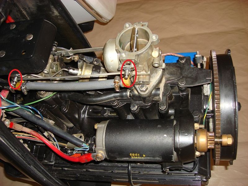

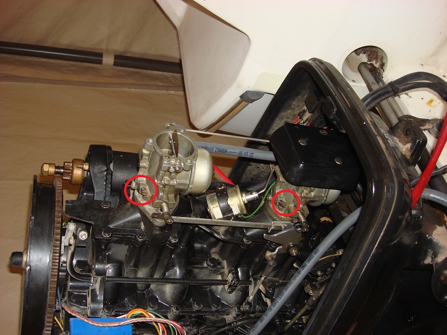

The marked screws on the second pic are the mixture setting screws. (I would start with 1/4 turns) The ones on the first pic are just the choke linkage sync shaft screws. Don?t touch theese.
Then you have adjust the idle stop screw a bit clockwards after opening the mixture screws. You will find the stop screw on the towershaft. You can see it on the second pic, just under the grey fuel hose going to the fuel pump. It has a stop nut on it. Loosen the nut and screw the whole inwards a bit until you have the right idle speed and then retighten the nut.
