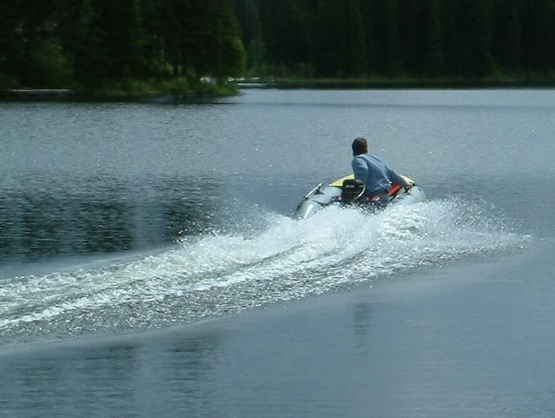

I have a 10ft Zodiac with a 15hp Evinrude on it. the OEM prop (9.5x10p) had lots of cavitation/ventilation issues. I switched to a Pirhana prop (10x11p) and it settled down a lot. Also I mounted a set of Smart Tabs on it and they made an incredible difference as far as holeshot and the time it takes to get on a plane (about 1/3). It just kind of gives a little "grunt" and it's up and gone!<br /><br /> http://img.photobucket.com/albums/v48/Snowdrggn/Zodiac/Dscf0051.jpg <br /><br /> http://img.photobucket.com/albums/v48/Snowdrggn/Zodiac/Dscf0052.jpg <br /><br /><br />Just my 2 cents......
