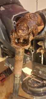

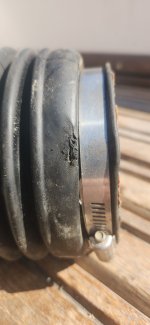

I have to replace the gimbal bearing due to water getting into the U-Joint Bellows. I may also have to replace the U-Joints as well. That was caused by a clip from a grounding strap getting loose and wearing a hole in the bellows. See pictures
It would be helpful if there was a plug that I could remove and check for water Before it does all this damage. Is there a way to do that?

gotta love the way people tighten worm clamps .
tip and lesson : tighten the clamp till it makes a consistent contact with hose or whatever > tighten 1/2 a turn after that , check for leakage , no leak leave it be , if it leaks tighten a tad more till no more leak .
there is absolutely no need to tighten a clamp that tight with a breaker bar so the hose is ozzing out all around it .
Op not saying this is the cause , its just something i noticed in your pic ,that hole looks as if its been stabbed in there or possibly some prying has been don at some point to cause a weak area..
I'm not sure how the hole got in the U-Joint bellows. It might have been the clip to hold the ground wire on the hose clamp somehow got pinched in there.
I don't believe I over tightened the hose clamp. I also smooth out the mating surface with a Scotch Brite pad before putting on the bellows.
You suggest checking for a leak after tightening the hose clamp onto the shield (If that is what it is called) How can you check for a leak except by removing the OD ??

""You suggest checking for a leak after tightening the hose clamp onto the shield (If that is what it is called) How can you check for a leak except by removing the OD ??"""
my comment was in general on the tightening ( yes i know you cant see in there ) , as posted " it was probably not what was causing the water intrusion.
the overnighted hose clamp was an observation that i notice only too often .
when people tighten these thing.
example :i once saw a $500 replacement intercooler pipe destroyed when than incompetent idiot service **** used a impact to tighten it.
sorry if you were offended by my pointing out that your bellows was overly squashed by the clamp.

@ Stresspoint I'm glad to learn to do this better. What makes you think that I over tightened the hose clamp?
stresspoint
Sep 19, 2022
1,045
it appears to be squashing the rubber on the bellows a little much for my liking , in an area like that it is critical to have thick rubber making contact with the metal surfaces , a squashed surface reduces the thickness of the rubber .this can also make the clamp act as a knife as the bellow works .
could be that it is a bellows that was reused upon assembly and it was already squashed.
either way , the bellow needs to be replaced with a new one , take care when tightening .
