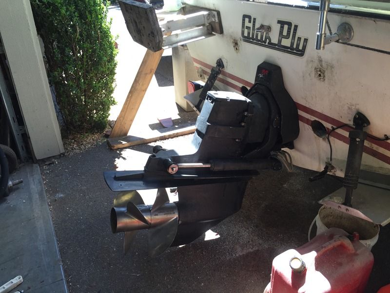

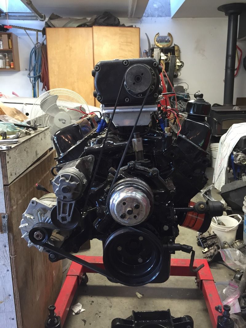

Hey guys. I am a few months deep on a full power train swap. I have a 19.5' glasply hardtop that had a Merc 470 and alpha 1. She now has a supercharged 351w and a bravo 3. We have had many challenges but managed to over come all of them. But I have one question. The alpha shift plate has the shift interrupter and a hydrolic reverse lock or something that I no longer need. Question is. The alpha shift plate. It has linkages. Will the bravo shift cables bolt to them? As in is the throw of the linkage the same as the bravo? I know the bravo shift plate is slightly different and just wondering if I should just try and find one?
