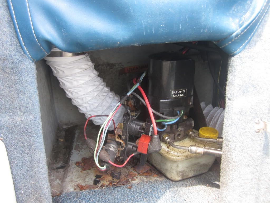

Does anybody know what this part is?
the mount for it is corroded and it just sits there now, i don't know if it is the cause of the problem but i am having a hard time finding out what it is so i can find a new mount for it

Re: Boat bogs down when cruising, can't find the problem
That is your hydrolic pump for the trim
