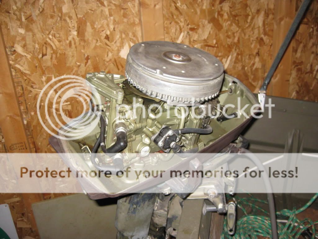

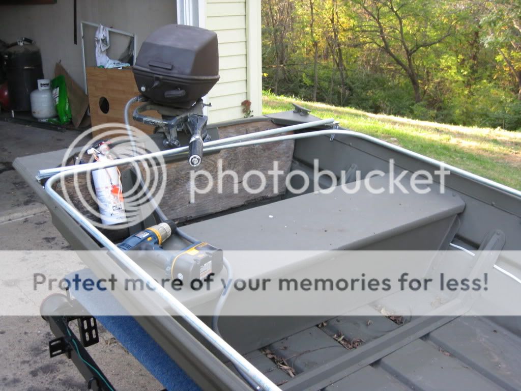

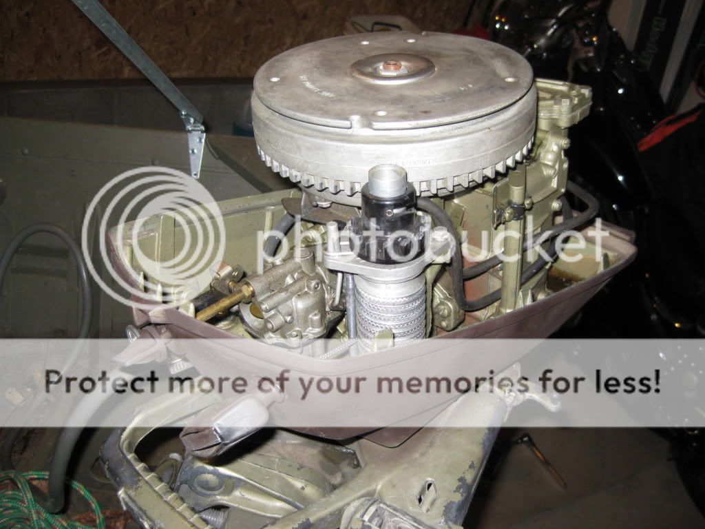

Hi guys,
Looks like lots of good info out here. I have my first outboard motor and am looking at using it this weekend. Its a 50th annivesary 6hp Johnson. I couldn't find serial # on it but have been doing some research and believe its a have seen where someone said 1965 and 1972. (I would like to get a manual)
I looked through the cold start procedures on the sticky, VERY Helpful!

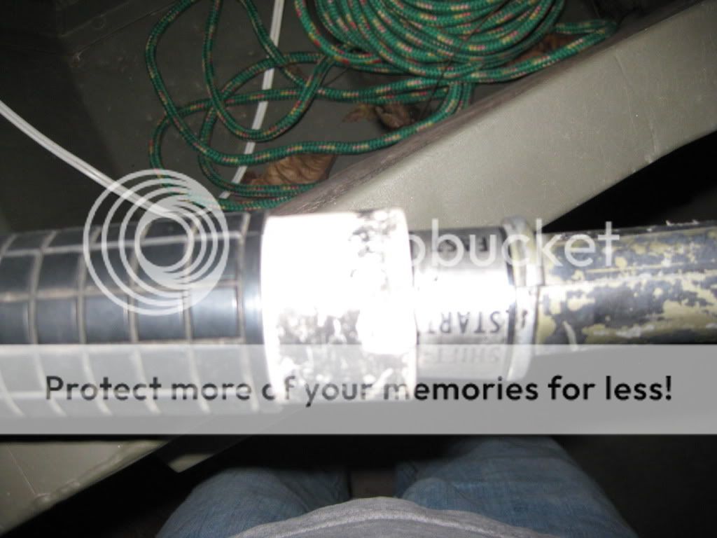

The question I did have is regarding the tin piece where it says start, shift, etc. The person I bought the boat from said his buddy somehow moved it. How do I know I have it in correct place? Also should the throttle handle spring back (like on motorcycle)? I've attached a picture.
Any other info you guys could suggest to me would be great. Thank you

Sweet motor! Doesn't appear like it's been wrenched on much (and that would be a good thing). The aluminum throttle locator plate is not very accurate anyway so don't worry about that. After you use your motor a couple of times, you will get the hang of it. Since no two motors run the same, you will get the "feel" for the motor you have. I think it's a '71 but check the aluminum freeze plug on the motor, or look for a tag on the transom clamp for a model number and post back with it.

The original paint, which is showing on the powerhead and the interior of the lowwer cowl, suggests a 1972. If it was a '65 and had original paint, it would be white.
Look for the data plate, which will be located on the port side transom clamp, if its still there. If its a 72, the model number should be "6R72D or 6RL72D."
The answer to your question about the throttle being spring loaded like a motorcycle twist grip is no, it is not.

Thanks for the info guys. Does the shift put the boat at slower RPM? The lever on the side is that for Forward, Nuetral, Reverse? I can't imagine this thing would have a reverse, but then again I know nothing little about these motors.

It's not from 1965 - the cover latch was on the cover in 1965.
What's on the welch plug on the engine block?
The shift lever moves forward, neutral and reverse. Turn the tiller handle counterclockwise to increase RPM.

If it is a 50th anniversary model then it is 1972!
