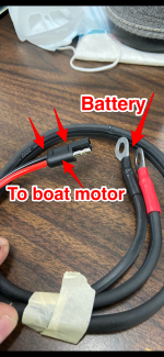

Battery to motor connection. 15hp Evinrude w/electric start.

This is the SAE battery cable connection I was referring to making. The one coming from the boat will have the same SAE connector. I will connect them on the lake so my push button starter will work, then when I park the boat in the garage, my trickle charger has the same SAE connection. Just wanted to share..

look at the current rating of those terminals and the current rating of your starter motor
