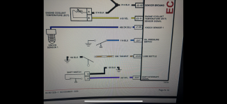

According to the schematic in the service manual, they do short to ground to initiate alarm. See attached picture

43,707
To test the alarm, find the engine harness to EFI connector. It's a 4 or 5 pin flat connector on top the motor. Then find the Tan/blue wire and ground it
