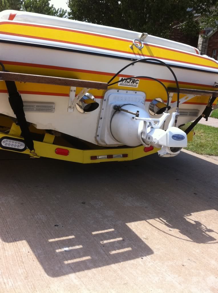

I went to a marine supply place that sold newer boats, the guy told me my 73' sleekcraft is way too outdated and will get horrible gas consumption on the lake, I have not taken it out since I got it and it has twin 30 gallon tanks, do you think this is enough capacity for a day out on the lake? im not gonna race around, just cruise. It's a 23' executive by the way, is the guy right? are jet boats that primative? you guys know more about this so let me know if I bought something that sucks more fuel than my escalade with a 6.2L

Tell us what motor, carb(s) & jet drive you have. Photos tell alot.

My boat has a stock 455 olds with a 650 edelbrock and rebuilt heads with performance marine transom headers, as long as I get a full day of use I would be a happy camper :)
