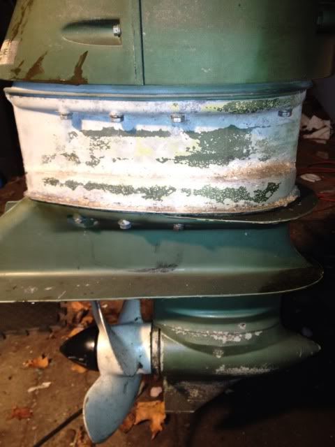

I want to replace the middle section on the leg of my motor. It's got some kind of white corrosion all over it and is unsightly. I have a good leg section on my parts motor and just want to swap them out.
After looking at the parts diagram, I noticed that there are supposed to be gaskets on the top and bottom of the middle section. I'm sure that I don't have a gasket between LU and middle section....and I'm not sure I have one between the middle and top portion of the exhaust housing.

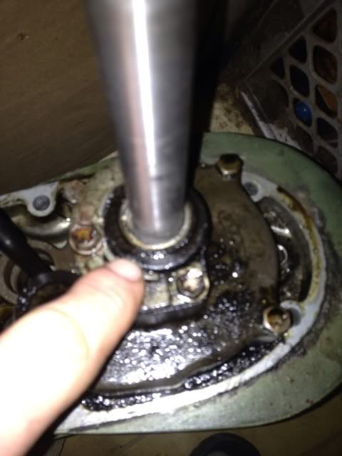

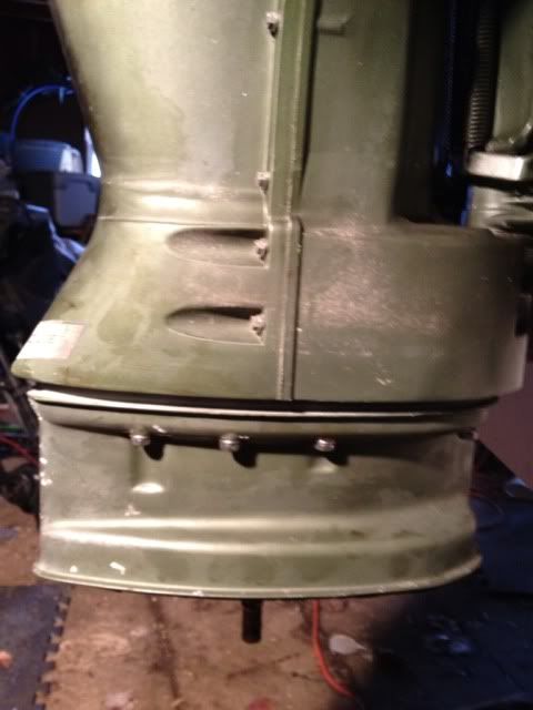

I just swapped out the housings. Pretty simple. There was only a gasket between the lower unit and bottom surface of the extension section. It looks a lot better now.
F_R, Is the black gasket in the pic the part that you're talking about? Water is getting into the gearcase, so I plan on pressure testing the LU soon to see where the water is coming in from. Should I test the LU first with the water pump housing on....then with it off? Last season, in the handful of times I took the boat out(cause I got it running late in the season)...I changed the LU oil after EVERY time I ran it. I'm getting the equivalent of 2-3 shot glasses full of water each time out.

That is the seal I was referring to. It has NOTHING to do with keeping water out of the lower unit. But it has everything to do with keeping exhaust out of the drive shaft tube.
The oil seal for the drive shaft is below the water pump.

The seal that you are pointing to (if it is the one that is installed "within" that 4 bolt housing)...... it may be in perfect condition BUT if the bearing within that driveshaft bearing/seal housing assembly is worn, leakage will take place at that point, allowing water to enter the lower unit.
With the lower unit drained, applying 7 to 12 psi to the unit and having the unit in an upright position, grab the driveshaft and try to move it sideways, to and fro, etc. If you can observe leakage when trying to move the driveshaft, replace the bearing and the associated seal(s). Some housings have 2 seals, some only have 1.
