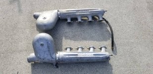

I have the motor and just came across the Nicson exhaust manifolds. Hoping to get em to work together. I won’t be using the OMC cobra drive.

those are jet boat exhaust manifolds. no way to use them with an outdrive. even if you get them bolted up, they sit too low in the boat.
