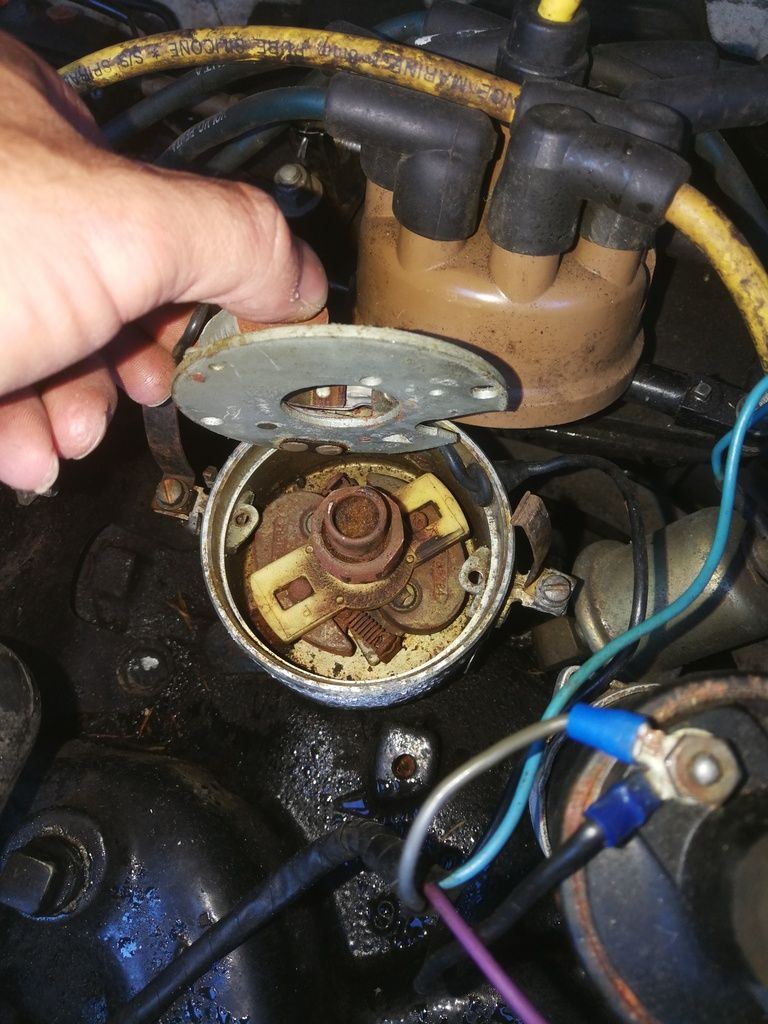

Lots of excellent info here, thanks everyone! I tried to post a pic but it keeps saying file too big and doesn't work! I only have my phone to use as I don't have a computer! Gonna try a different way

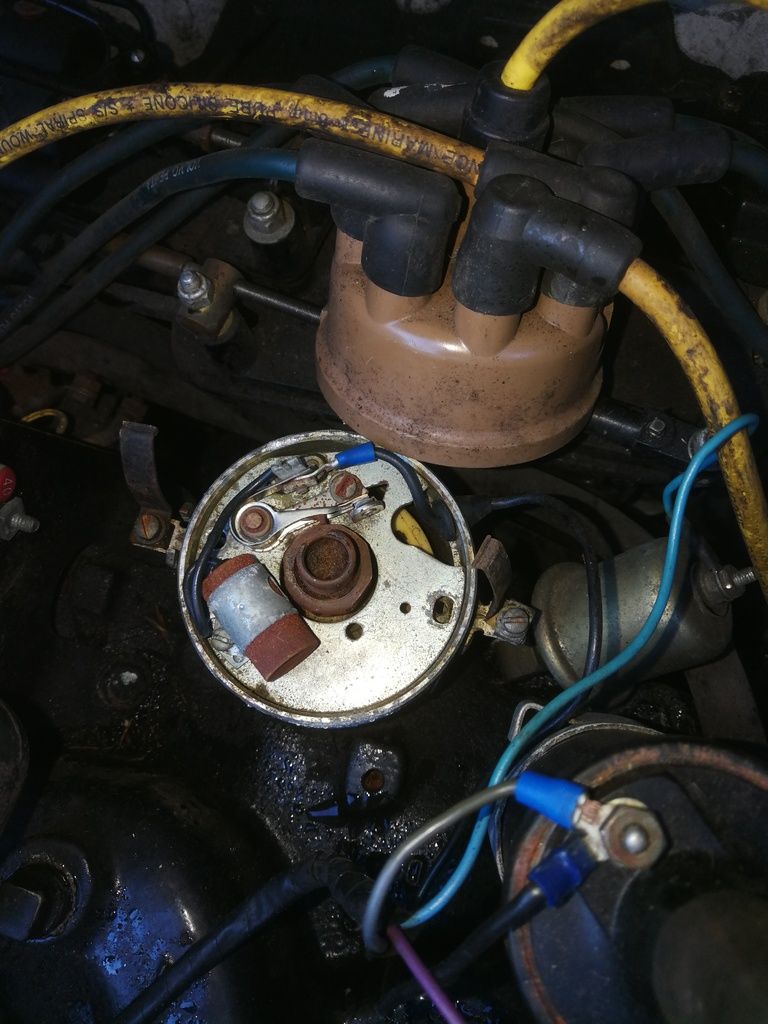

Points distributor
I would suggest mark the location of the rotor in reference to where its pointing on the motor. Disassemble the distributor an clean it up, the place back together. Reinstall new points and condenser, and adjust points.
Reinstall distributor with rotor pointing in same location. After all the wires back on, reset timing

Ok so I have an update! Went to carquest auto parts and explained to the gentleman behind the counter my problem and he was like, looks like a challenge to me! So he went through his parts book and not surprisingly there are a ton of different points systems and by the picture I showed him he started looking for a match, he went to the back bringing out several parts until he came across that seemed to be a decent fit so I grabbed it, along with a condenser that looked similar. Went home and switched out the parts which seemed to fit right away! I set the clearance at 25 thou, not sure if this is the spec but just went with what the old boy said to start at! Hooked up the hose turned the ignition with my fingers and toes crossed and thankfully she fired up straight away without any effort! Man am I glad! Turned out to be a $40 fix which I like way better than the $550 the shop wanted for a new distributor! Really pleased with the parts guy! And certainly couldn't have done it without all the knowledge passed on by the veterans here! Going fishing this weekend! Thanks everyone!!
