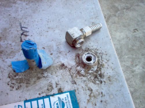

When I was rebuilding my Checkmate I just couldn't leave well enough alone and felt the need to pull my pickup tube just because, and here's the result of that idiocy. I got it out with an easy-out pipe extractor, here's a link: McMaster-Carr
AIM000437.jpg~original
