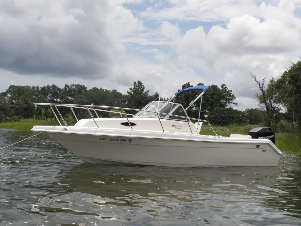

I would like to install an anchor windlass on my 1998 key west 2020 wa. I was wondering which one would be the most practical one to buy. I do like to fish the inshore wrecks in 15 to 60 feet of water. Is there a windlass that I don't have to tie the anchor rope to a cleat when anchored?
