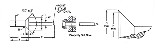

I enjoy working with aluminum and have set hundreds of solid and blind rivets in older boats but never on a canoe. So I see you're dealing with some very thin material and bracing is very important to AL. You already have pretty much all of the options out there at least that I can think of. So I guess now you're seeking opinions. Mine is either solid or blind rivets.
Solid rivets are what the canoe was manufactured with and this is the most difficult / expensive way to repair a single or a few leaky or missing rivets. The solid rivets are cheap but everything that's needed to set them adds up quick.
The bottom of a canoe takes a serious beating as seem in the pic you posted with all the scratches. Repairing this with a blind rivet is an option. They also make countersunk closed end blind rivets but they're what I would think of as being a specialty and not found in too many stores, only online or in a fasteners store and then not an easy find. The countersunk heads I have aren't closed end but I don't use them below a waterline either.
fetch
I would recommend against putting anything there that is protruding above the surface to get caught, be sure it's countersunk in the hole. The easiest and least expensive way are blind rivets. You have to get the blinds in the correct length too, obviously too short would not be good but too long is an issue as well. That brings us to grip range of the blind rivet. You have to be in that range for the rivet to become tight and not have it loosen over time and for the mandrel to break correctly. It's really a guess but those look like 5/32" dia rivets. Also the degree of countersink, 120, 100, 78 is a guess? Blinds sold are normally 120 degree.

Hi Waterman,
Thank you for your reply. I am not familiar with this whole process...i.e. rivets...and the many different aspects to be considered. I have learned a lot just by reading your reply. I am not afraid of attempting something new....but I can see now that even though the job looks simple....there is a lot of homework to be done ahead of time, if your a novice like myself.
Mr first question is in regards to grip range. I assume that in order to determine grip range...I need to get a pretty close measure of the "hull thickness" PLUS the thickness of the cross brace I "pictured" on the inside of the hull. The schematic that you included looks very interesting to me and I think that perhaps I need to see the rest of the document that the schematic came with. Could you tell me where it is from? I think I need to find "basic riveting" information and perhaps that document could be good place to start learning the terminology necessary for this job.

I normally post a link to the info I'm posting, here is where I got the above image and where I buy most of my rivets online.
http://rivetsonline.com/rivets-en/bl...nd-rivets.html
The problem I have with SS machine screws is finding one that will be properly countersunk and would be flush with the bottom. If you can find a size that works then the screw with nyloc nut with 5200 to seal the water out is a viable option for repairing your canoes leaky rivets. If the SS screw head protrudes the risk is that it catches on something and rips out creating a larger hole in the bottom as the SS is considerably stronger than the thin AL around it.
All that being said, I have all the equipment to set solid rivets so that would be my first choice on the repairs.
