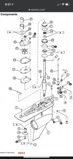

When I did my water pump, I replaced parts 23 and up, I suppose it could be the lower seals #19 allowing oil up into the water pump housing. Like I said above though, it didn’t make sense that that the entire system had oil in it to the point where the reservoir was 1/4 full before it started to leak from the water intake.
