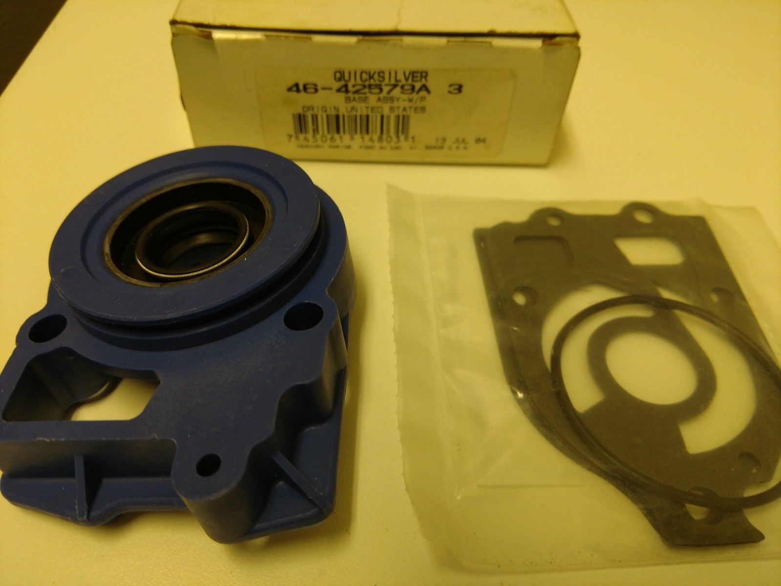

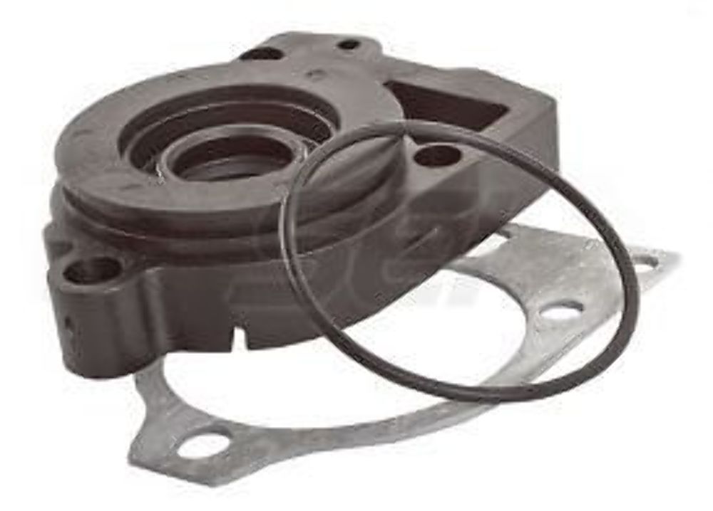

ok, i bought a new impeller kit with base, pulled the base off only to find out the one i bought does not fit, this drive has a pin on the unit that the new base will not fit over,
the 2nd base i bought has the section cut out to fit the little pin but the base does not fit in the hole to keep the oil in, the base has a smaller circumference

no, the driveshaft does not have a preload pin. i am working on 2 drives, one is from a 1990 merc, serial # oc837937, that drive takes base
https://i.ebayimg.com/images/g/1UAAAOSwCPdZ662r/s-l1600.jpg
the base shown above has a notch in it to fit around a little button/dowl pin on the lower case.
the other drive is an 89 counter rotating drive and i got the info based on serial # on top of the flame arrester is oc630165, who knows wha has happened to this boat in 30 years though.
that one has a 2 piece base and the piece that the o ring sits on is smaller than the above photo
the unit from the 89 does not have a button/pin on the lower case

the serial number says it uses base 46-44292A3 .Same base as the Alpha 1 and Alpha MR
No base is 2 piece My guess is that this part broke free from the base and is in the drive
