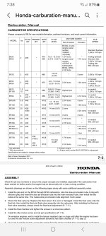

BF40A Sn BAYL-2000515
Had some bad gas so I cleaned the carbs and replaced main jet #92 99101-ZV5-0920
as well as jet set 16150-ZV3-000 and seals and gaskets.
I don't know if my BF 40A sn BAYL-2000515 wants an initial 1 5/8 turn out on the replaced pilot screws or 2 1/4.
The service manual seems to indicate BAYE and subsequent want 1 5/8 turn out.
It will not idle except with about 1/4 choke.
Carbs were balanced but the idle circuit must be clogged?
If i close the choke it will not idle (it dies).
