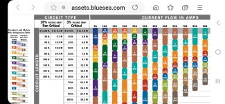

look at this.

Posted before I realized your out of scale..... you should be able to find another ampacity chart for dc though. It will compensate for length/voltage drop
51,874
ABYC recommends 18 gauge, minimum not for capacity, however for strength
22 gauge can easily run 5 amps thru them, however in a lighting situation, you are only running about 3 watts.
the 18 gauge you bought will be more than adequate.
