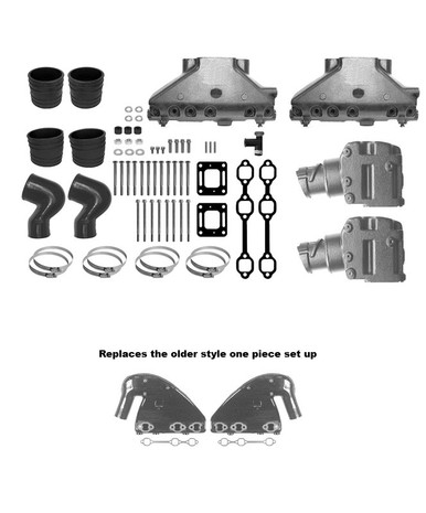

There was an article on another website about it, Merc apparently did this to save $50 per engine, due to the Vortec engines costing slightly more, and what caused the problem was that they couldn't get consistent wall thickness in the castings, so some had really thin areas that rusted through fairly quickly and let water in the engine. So Merc came up with a conversion kit to allow you to convert to the 2 piece design without changing the Y pipe, and Barr Marine also makes one.
I had OMC's version of the same thing (used from '85-'90) and they were not known for failure AFAIK and I had them on my engine from 2004 to 2017. I changed the original pair it came with in '04, then again in '11, and by '17 they were due again to be changed (salt water boat) but had long been NLA so I converted mine then to the 2 piece system OMC changed to in '91 and Volvo used after they bought out OMC's sterndrive division right up to when they had to change to the dreaded cat converter exhaust.

Those are Merc's Batwings, same idea cast all in one piece.
Besides saving money the one really good aspect of the design was no gasket to leak between the manifold and elbow. But the difficulties in the casting process caused so many warrantee claims I'd think that Merc quit making them.
here's an easy way to remove the risk of hydrolocking your engine if and when the batwings fail.
this place is kind of local to me, when I buy exhaust I get it from them and don't have to pay shipping
the risk of not changing it is that you won't know a failure is eminent till it happens then you'll have water in one cylinder or more. If you try to crank the engine over not knowing why the engine won't crank you can bend a connecting rod. Many think it's a starter problem when in fact it's not, water in a cyl can't be compressed, if you try to start it you can bend a connecting rod!
Lou C
Nov 10, 2002
13,797
It is, you just replace the whole exhaust system with the one I linked above, pricy but can avoid ruining an engine. For us in salt water we have to do this every 5-7 seasons. My engine is on its 4th exhaust system and probably will get at least new elbows at the end of this season.
