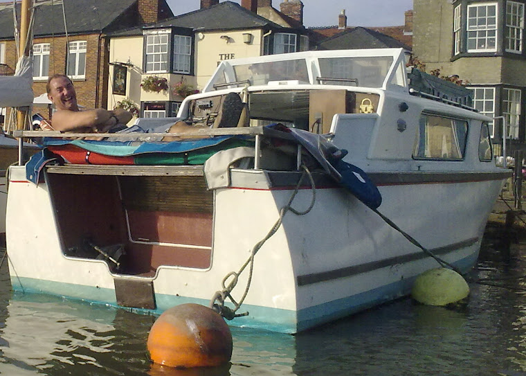

Looks to me like the transom has been modified for a small outboard.... I suspect that that boat was originally an inboard.
It does look like a decent albeit odd splashwell was constructed with drains and all.... If you haven't already I would inspect the splashwell area and it's construction VERY thoroughly. Make sure it is very strong as with the sheer size of the area, a large wake or wave could put a lot of water in there and the structure needs to be able to withstand the pressure until the water rolls back out... I'd also consider using some sort of a jackplate with a longer shaft motor to keep the powerhead of the engine out of the water.
of course this is just my .02

Actually now that I think about it, I'd build up the transom and raise the floor of the splashwell along with it's drain holes.... In the pic below, the powerhead of the engine would be about 1-2" above the surface of the water..... You would be on the edge of disaster if you loaded up with people and went for a cruise

It was given to me with a Johnson 4hp outboard, and the transom is designed for it to clip on the back (sorry - I'm not used to boating terms yet). I've had the motor serviced but it doesn't have reverse, and is not powerful enough to go against the tide on our River Colne.

Much like Home Cookin', if you were venturing out beyond the canals and inland waters - I'd be with Smokeonthewater about rebuilding the rear end on it. But where you're going to be running, a smaller outboard would work.
The 4HP scares me a little though. Once you're under way, there's quite a bit of inertia built up in a boat that size. I would want more power than 4 horses to maneuver more quickly and/or stop. Problem is I have no clue as to if 30 HP gives you enough for that?
I also agree that the transom looks REALLY low. I wonder if they made particular motors for that application?
