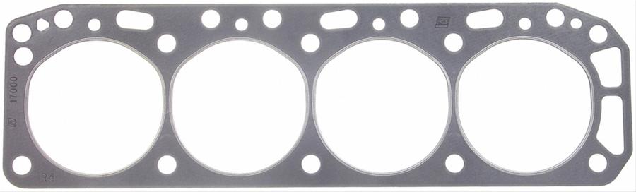

Almost looks like the gasket is backwards, and yes the gaskets go fit perfectly backwards, ask me how I know that
FEL PRO 17000
