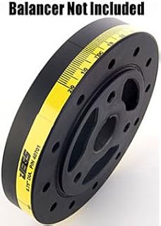

51,875
the other alternative that Chris mentioned is timing tape
which is what you appear to have
