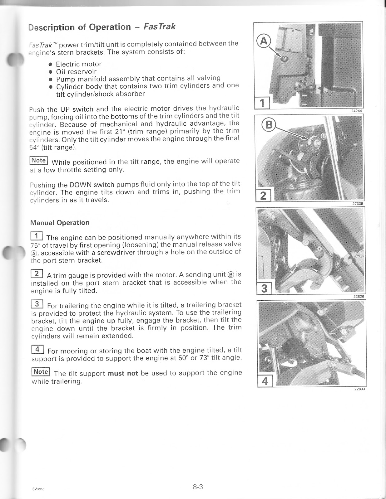

Here is a page scan(see note 1/3 way down) from my OEM service manual that describes why the OP cannot raise the motor beyond the "trim" range of motion while in WOT mode. I have never tested the system on my J150 to see if it works as engineered, but it has piqued my interest and I'll see what happens next time out.

OK now think about what the actuall wording that you directed me to says:
he is at WOT, and his trim wont move past a certain spot
the text you sent me to says, that the motor will not operated beyong low throttle speed once into the tilt range.....well the OP is at HIGH throttle range.... so if he actually went INTO tilt...he would SLOW DOWN.....but thats not what he said is happening.
in reality these issues can become muddled if the trim sending unit is mis adjusted!
BUT if it were miss adjusted to THINK the motor was in the TILT range when in fact it WASNT...then his rpms would drop into the low throttle range.....like described in the text you posted.
