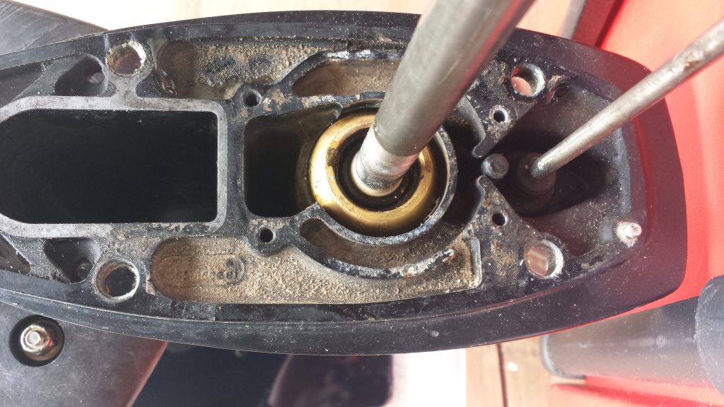

Whenever I push the throttle down it just revs up and doesn't go anywhere. It transfers into reverse and foreward but never goes faster than like an idle. I've been able to take the lower unit off and I was able to get the water pump off then I got stuck. I'm trying to check the bearings.

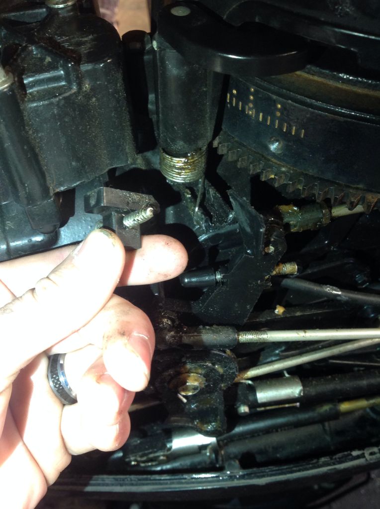

Not sure what the little part is you are holding, or where it goes.
oldman570
Mar 25, 2011
1,615
The small part you are holding looks to be the adjustment stop for the lock dog for the flywheel. It is so the motor can not be started while the motor is in gear, and the lever above in the picture is where it should be connected to.

Thanks ill look at the hub. That peice is exactly what u said. It's part of the recoil starter assembly. All the linkage seems fine except that broken peice. The boat will push at like 1 mph just from being in gear. But when I give it any gas at all it just revs up and does nothing.
