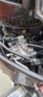

I have a 93 Gamefisher 9.9 and am looking for a carb as mine is not repairable and no replacements I can find. Does anyone know of a carb that will replace the factory carb?

They used 3 different carbs depending on the model/ serial #'s??
If you can add those #s I might be able to help???

Nope, I need the model# (serial# if possible?)
Look on the transom or mid section for the mod#
Or maybe a few pics of your carb???

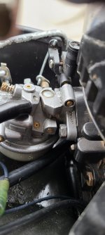

Here are the pictures of the Carb.

Even with numbers this is gonna be tough to find.
Try Franz Marine and then start looking for Marine
Salvage yards.
They used this carb on Mercury and a whole bunch of
other applications from 1984 to 1997
What's wrong that the old cant be rebuilt?

Thanks for the replies. The Carb currently on there has bad seat which is no longer a part available that I can find. Unless as you said I can look in salvage yards for one.
