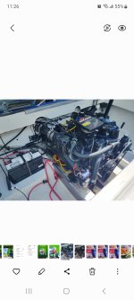

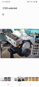

Finally, we have the new build ready and installed for the SC1. Went from a 300hp 5.7 to a mild built 355.
(1981 4-bolt K block, steel chev crank, 218 / 224 cam / Trick flow 180cc alum heads / beehives / forged rods / slugs, flat tops, light ring pack, RPM intake and 1409. Stainless Mar. manifolds)
Figuring the lessened weight and added hp and torque should reliably put this hull at 65+ Excited to get it dialed in and get the summer sandbar going. Cheers from Ontario fellas.
