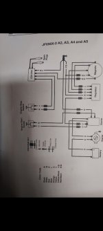

After installing a cdk2 and then bored it out to 40mm with the 750 jets & low / high speed screw set to a 91650specs it.runs great. Until a no restart. No spark. And a Secondary coil reading of 16.2k. I'm thinking the regulator rectifyer is spent.& not charging the battery with enough CCA? Any help ? The books specs.is 2.1-3.1k . The çdi coil is still hooked up so maybe the high resistance is the regulator rectifyer is bad and causing the 16k reading? I hope this makes sense. I ran the Ski long enough to warm it up and set an awesome steady idle. It was a long enough time to kill the battery's CCA instead of keeping the battery charged.
