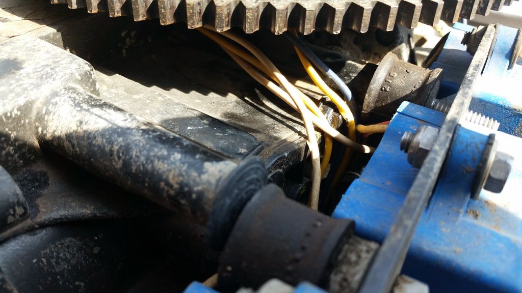

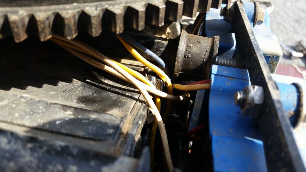

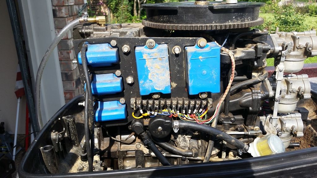

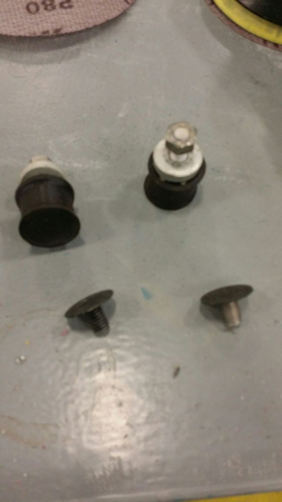

I have a few wires that are resting on top of the block that are attached to the stator that are slightly melted. Any ideas besides electrical tape on how to protect these wires I would hate to have them short out. I've thought about taping them and then using some exhaust wrap underneath them. The second issue I am seeing is that the coil backs seem to be only held on with one bolt. The problem is no matter how tight I get the nut it sags down and hits the fuel filter. Am I missing another anchor spot? I'm trying to attach some pictures. The boat engine has been starting fairly well I usually get a loud pop at first then she fires right out. I've cleaned and inspected the carbs, added a second filter and set the idle needles at one full turn from lightly seated. Is this backfire/pop on initial startup telling me something or am I good to go? Thank you in advance.

If you can slip on some heat shrink, that would be the better choice. But for a better suggestion, we will need pictures for sure... Try posting then again...

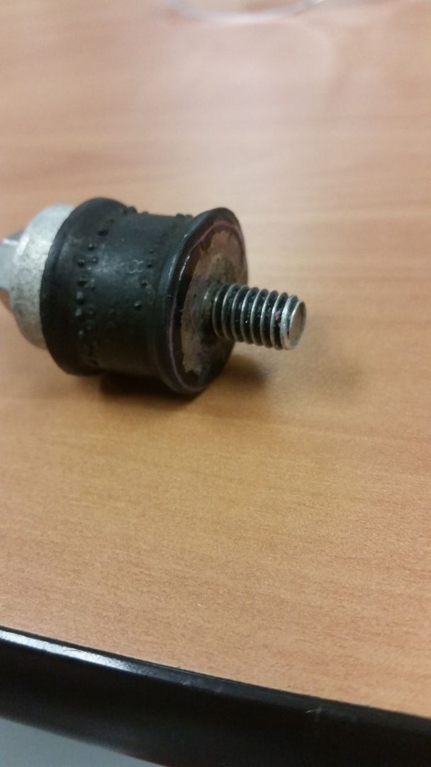

It is sagging because at least one top rubber mount has broken and the other top mount is missing a spacer and nut.. Either replace any broken ones with new or use a bolt and spacers and definitely replace the missing spacer..
Once you stop the sagging the wires will no longer touch the block. As mentioned above heat shrink tubing will work. OR (easier to apply) the spiral wound wire protector which is what I use. It is available in electronic shops and possibly the big box stores
You can try gluing the rubber isolation mount with a good industrial rubber cement but I have never had any luck with this.

Well now i feel stupid haha thank you frank, you are wicked fast at replying. Any idea on where to buy new rubber mount? Do you have any thoughts regarding the backfire/pop at startup? Again thank you! If the flood waters will recede here in Texas maybe I can actually get on the water.

The shock mount is NLA and most break when taking them apart.
I looked and don't have one.
Maybe someone on here will have one.
If you can get the old stud out of the block, you can install a bolt in place of the part.
It can be rigged with a rubber grommet or piece of hose to sort of make a vibration free mount.

Got it thanks guys i for the studs out Ill probably just use some bolts and drill a hole through it. Thanks

Drill a hole through what? You grab the shock mount with a water pump pliers up close to the mounting boss and twist. It will unscrew right off. Then buy some 5/16 all thread and cut to length. Screw into the existing bosses. A couple of nuts and Bob's your uncle!
If the other two shock mounts are OK, then just replace the broken one with a piece of all thread or a bolt.

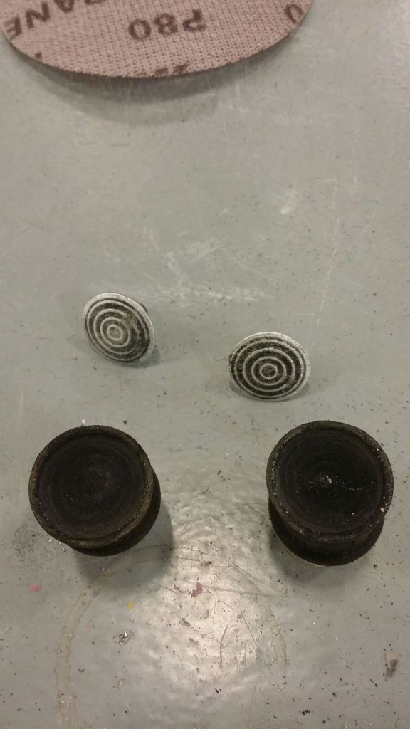

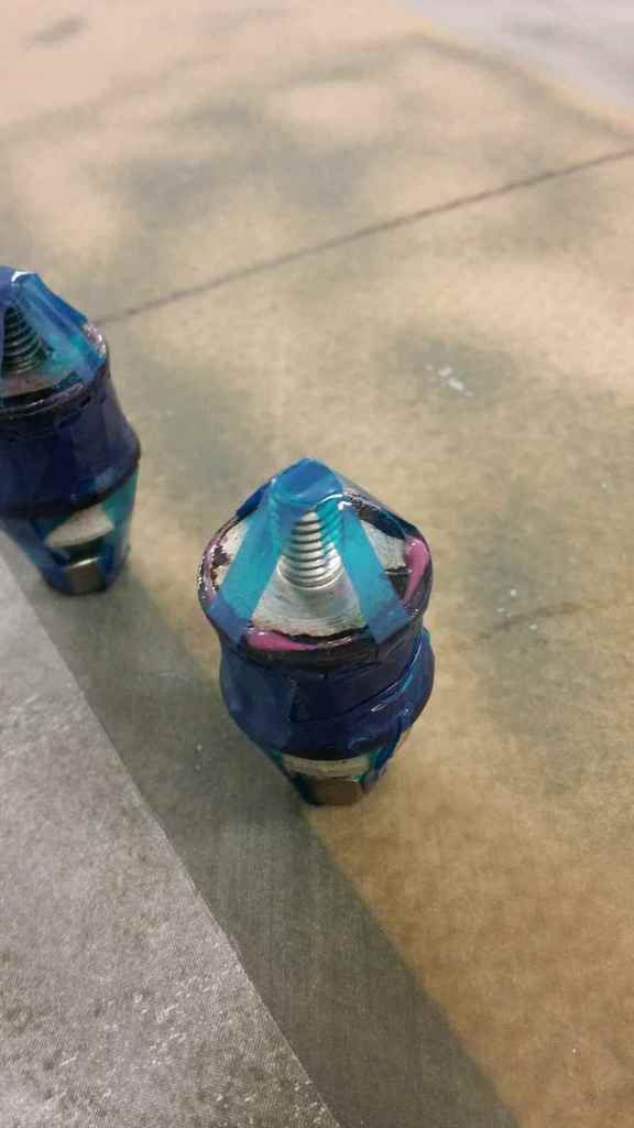

I was referring to drilling a hole through the rubber mount and just using a bolt. I instead used some aircraft 9309 adhesive and it worked like a charm. Thank you Frank.

Surface prep is everything I work in a composite bond shop where we basically glue blades together. I used 80 grit sand paper, acetone, 9309 and cook at 150 degrees. pnwboat is correct. This stuff holds helicopter blades together and basically bonds to anything, if you apply it correctly it is well worth the money.
