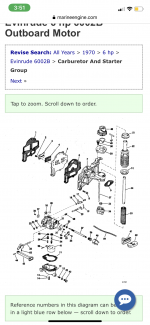

This is the diagram for my carb thinking I should just do a rebuild myself since the guy before me may have used cheap parts it looks like

do the easy stuff first
Racerone's post#4 is critical ...to progress you need to answer all questions
have you tried pumping the fuel bulb in case the engine is starving
Rebuilding these carbs may only entail a good cleaning of all passages and blow dry them. did you check the small side channel orifice feeding the top section ?
the air may be leaking by the LS needle temporarily grease (butter) up
the shaft to seal it 100 % (see causes in the above picture)
is the tank vent open ?... remove the cap

I also have a 6 H.P. Evinrude that I had a problem with idling & starting after I rebuilt the carb with new, CHEAP parts. I rebuilt the carb a second time with OEM parts and it was a world of difference. The cheap parts that I put it were junk. The gaskets literally softened and became distorted from the fuel in the carb bowl. Replaced the cheap parts and I was all set. Runs great still after over a year ago.
