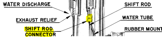

Are the 2 notches in the brass connecter lined up with the holes for the bolts ?----Is the shift adjusted correctly at the top near / in front of the carburetor ?

39,317
In the middle picture ---I did not know that there could be so many things wrong with these ignitions.------That is why electronic ignition is so popular.---When it fails you install new parts in minutes and away you go.
