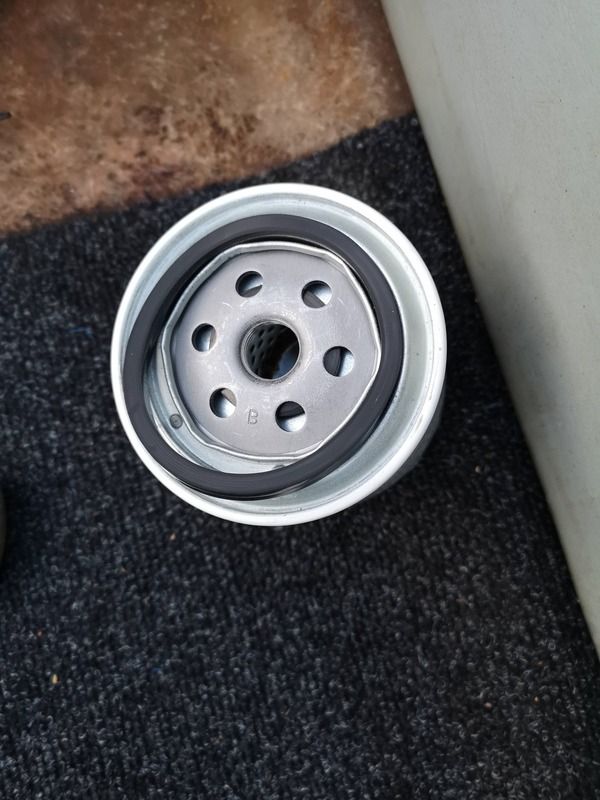

I have pulled the fuel filter and replaced it with a new one.
The last time I was having problems with dirt in the lines and tank so I have cleaned it out, changed the filter and now after about 5 hours I have changed the filter again. I haven't tested the new filter yet to see if that helps but the old one was full of fuel and even had some dirt and water in it so I'm hoping this cures my problems.
Also after the old filter sat for 30 mins the seal seems to have expanded
Note, the seal was fine once the filter came off so I don't think that would have caused me any problems.

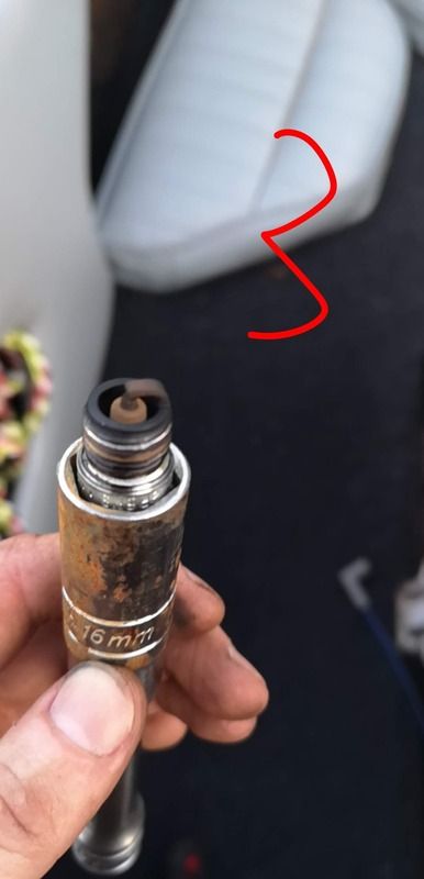

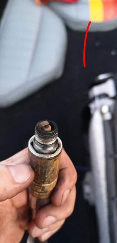

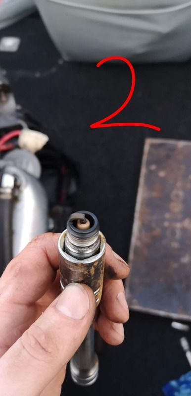

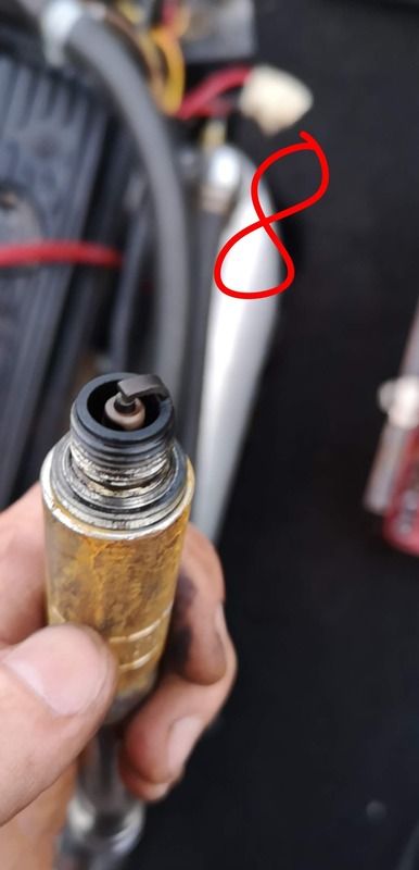

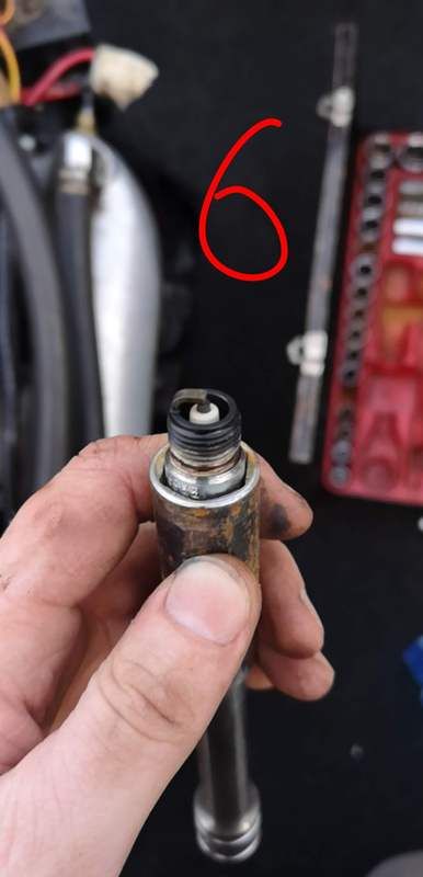

Here are some pictures of my spark plugs after fitting my new carb.
What's everyone's opinions on these?
